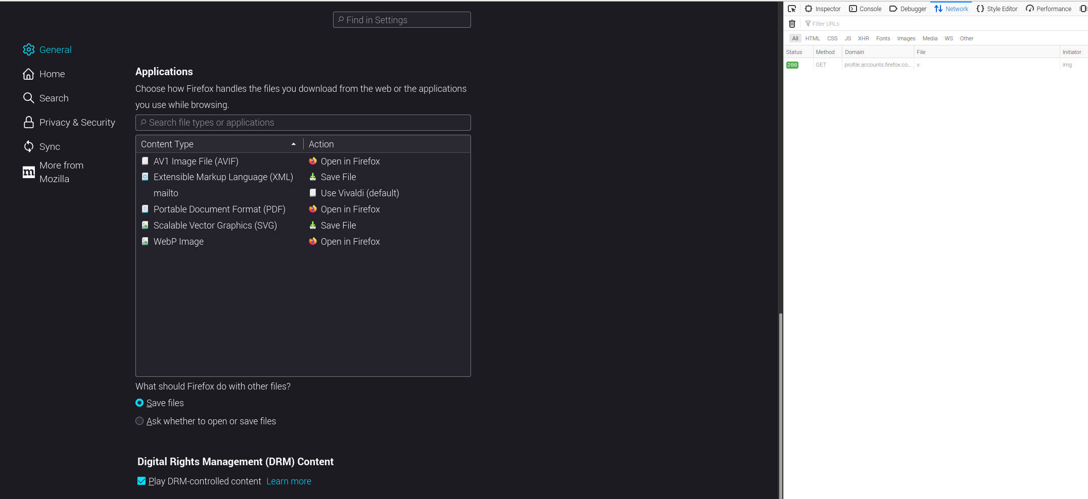

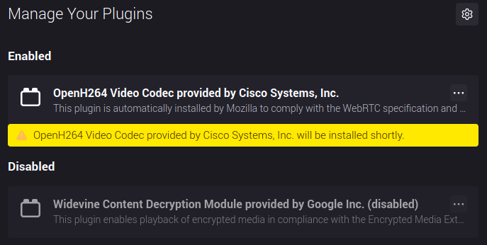

I installed Firefox-ESR on my Raspberry PI and noticed that I cannot play Udemy videos. After some research I found that the Widevine plugin is missing and the OpenH264 Video Codec is also not installed. Following the instructions from similar issues didn't solve the problem. I ticked off and on the "Play DRM-controlled content" button but this only brings the widevine plugin for a moment and after that it disappears. In the network tab I see no activity when click on this button, i.e. Firefox does not send requests.

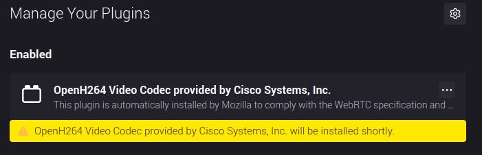

Additionally the OpenH264 Video Codec is not installed and never installs.
Any ideas how to solve this?

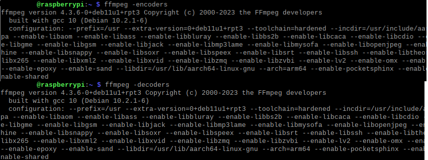

As far as I see the FFmpeg package is installed. I also checked the following commands: ffmpeg -encoders ffmpeg -decoders

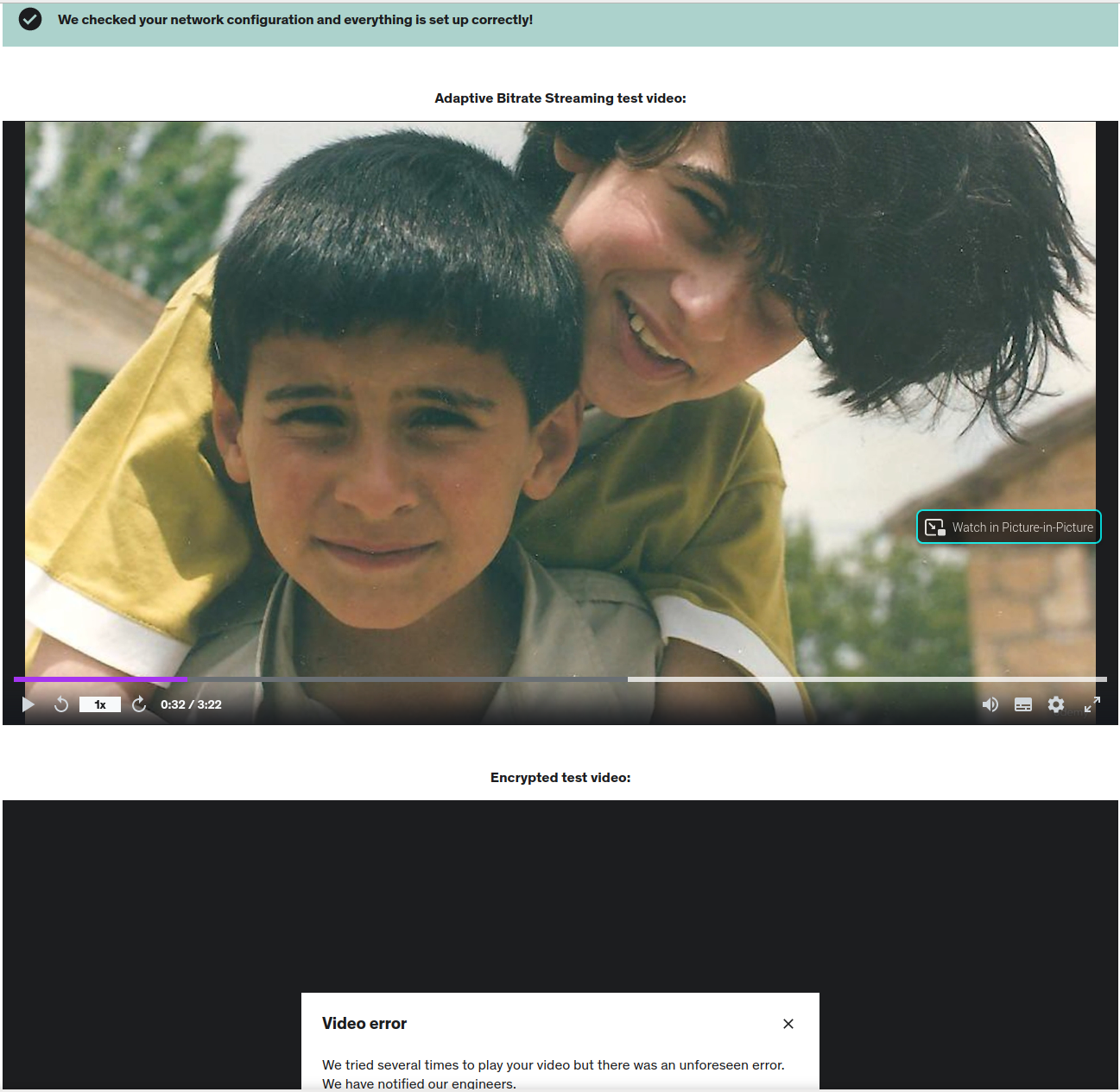

and they show the encoders and decoders are installed. In fact the system is able to play Youtube and other videos but the Udemy does not run - I receive an error message (see second picture below).

In my initial question I posted two screenshots - check the second one, this is how the Widevine plugin appears in the plugins section. When I uncheck the DRM checkbox Firefox makes one request which has nothing to do with the links where the plugin is located (it's in the attached screenshot).

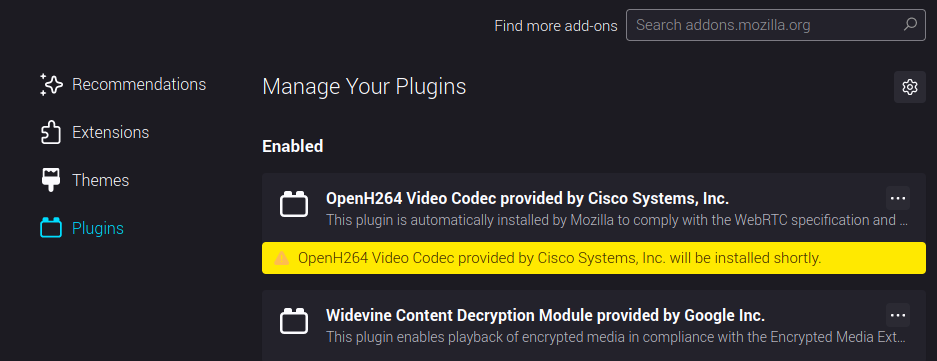

The version I see in the manifest file located in /opt/WidevineCdm is 4.10.2252.0 After I added these 3 preferences and now I can see the Widevine plugin in the Plugins section (see the screenshot). However the outcome of that intervention was that the Udemy videos stopped playing.
